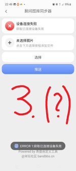

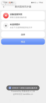

EN: Hi, this post is about the NEORUAA's Gallery Quick App.
So first of all, the app does not ask me for any permission (bluetooth, nearby devices, etc.).
But as soon as I connect to mi band 9 it displays this error: (image)
I'm just not sure if this app just doesn't work on the global version, or if I'm doing something wrong. The thing that is suspicous is that the app somehow knows when I'm connecting the device (when I do so the error displays). Thanks to everyone in advance.

Hello, I will use Chinese to answer for you. First, you need to connect the Mi Fitness & Health to the bracelet, hang it on the small window, and turn on the synchronizer. At this time, generally it will show that the device is connected as shown in the figure. Then click the second button to select the picture for pushing.

After my test, my Xiaomi Mi Band Global Edition can be synced, may be your usage error, please try again according to my method

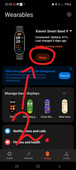

EN: Thank you a lot for responding - I've been trying to make this app work for like 2 months now and you are the first man that actually somewhat helped me. I just think that i dont understand correctly (the translation might be bad). So what I understand I have to do:
1. Open the quick app on the band
2. Sync the band
3. Go to the Gallery App
It didnt work. Also I am very sorry for my poor understanding.

国际版小米运动健康app很有可能不支持应用间通信
The international version of the Xiaomi Fitness app is very likely to not support inter-app communication
